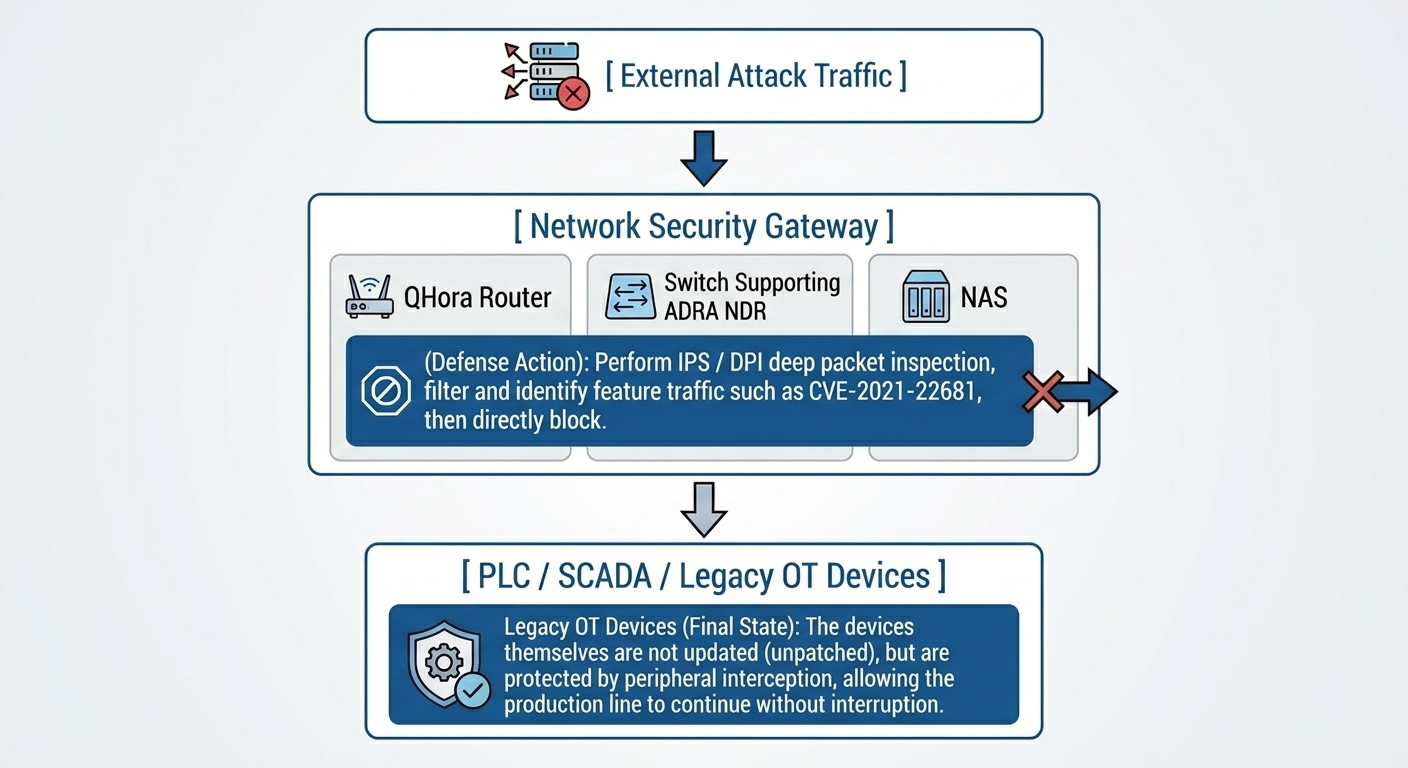

The Solution Isn’t a Patch, but “Virtual Patching”: Turning the Network into a Security Boundary
If devices cannot be patched directly, what are the options?
The cybersecurity industry offers a well-established approach for this challenge, known as Virtual Patching. The core concept is: instead of applying patches directly to the device, you build a “network-level defense layer” around it—so that malicious traffic targeting known vulnerabilities is identified and blocked before it ever reaches the target device.
The workflow of virtual patching is as follows:
By integrating Zero Trust Microsegmentation, OT environments can be further partitioned into multiple isolated security zones. Even if an attacker compromises one node, they are unable to move laterally across the entire factory network. This is the practical execution of what the industry defines as “Defense in Depth”.
